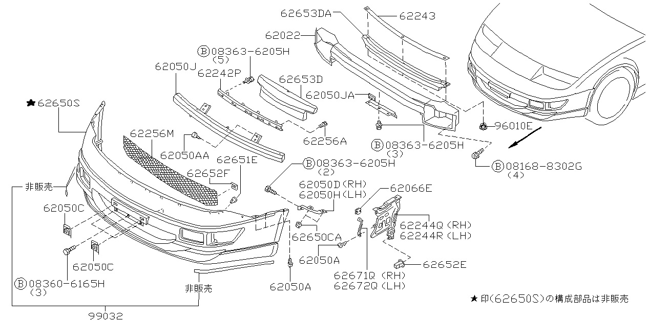

Message The mesh grill and there is a foam insert for the lower lip portion. It back fills the space and is held in by the 3 bolt metal retainer that holds the front splash guard in place.
On here it's marked by part code 62653DA
